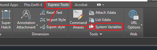

Have you tried??.......Express Tools Tab=>Tools Panel=>System Variables.
Express Tools=>Tools Panel=>System VariablesExpress Tools=>Tools Panel=>System Variables
Then make it look like this.
Enter ANNOALLVISIBLE in search box.Enter ANNOALLVISIBLE in search box.
After you've changed it to 1, go back to System Vaiables dialog window and verify whether it remains at 1 and hasn't  returned to 0.
