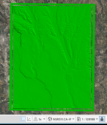

I solved the issue this way: reset (repair/reinstall) for Map3D application
Now it works
Thanks to ChicagoLooper and Pointdump for help.
