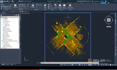

Is your point cloud .las or .laz format? If it is, you’ll need AutoCad Recap so you can perform a Save As to either .rcp or .rcs, both formats can be read by Map3D. Try as you might, you can’t bring in point clouds directly, you need Recap.
Don’t know if you’ve already found this video by Kyle Evans, titled Inserting LIDAR and Point Clouds into Civil 3D. Although the video’s purpose is to demonstrate how to create a TINN surface in C3D, he does cover the Recap part. To watch the video click >>HERE<<.
Do you know if your points are classified, i.e. ground, vegetation,trees, etc? If they are, Map 3D allows you to filter by class.
To watch how to classify points (from Seiler Solutions) watch this >>VIDEO<<.
