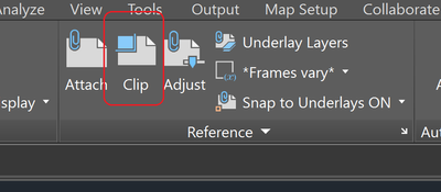

If you want to crop the image along your white line then use MAPIINSERT to attach your georeferenced image. Don't use Data Connection.
Insert Tab+.Image Panel=>Image Icon.Insert Tab+.Image Panel=>Image Icon.
After insert, you can use CLIP.
Insert Tab=>Reference Panel=>Clip IconInsert Tab=>Reference Panel=>Clip Icon
On command line, for select image=>click on your image=>then NEW=>then 'S' (for Select Polyline). Your image will be clipped using the white polyline.
