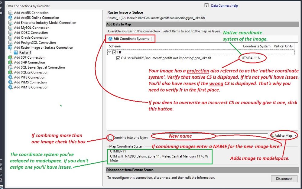

2. Since Global Mapper is a GIS program, the image's projection (coordinate system) is re-calculated and re-applied to the cropped image. Back in Cad, I use a Feature Data Object (FDO) connection, as opposed to MAPIINSERT, to add the image to modelspace. An FDO is more versatile than using MAPIINSERT because it can easily perform coordinate transformations. Use MAPCONNECT to get the Data connect palette.
<<BTW, using an FDO connection is capable of combining multiple images into a single image and is just as qualified, or better, than other programs.>>
 Click the Connect button.
Image-2Image-2
3. After clicking 'connect' button, verify the parameters of your connection, then click Add To Map button.
Image-3Image-3
