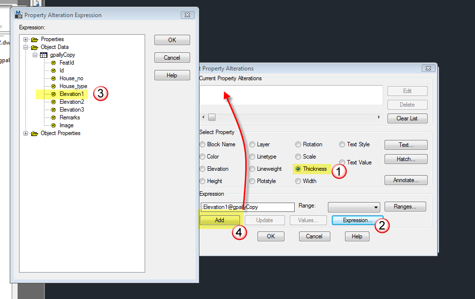

1. Open a new blank dwg.  Use mapiport to import the shape file and create object data during the import, make sure you check the box to create closed polylines from polygons.
2. Save that dwg and close it.
3. Open a new dwg or your project dwg. Use the maps dwg attach commad to attach the dwg you create in step 1. (Not Xref attach)
4. Create a query using location = all, and alter properties. in the alter properties section use the expression  :Elevation1@gpallyCopy.
5. Run the query in draw mode.

1. You will have to model the roofs on each one individually with the 3d modeling tools in AutoCAD.
2. They are not extruded plines and not a 3d solid/surface object they are a 2d polyline with a thickness.
3. The dwg once saved is a standard AutoCAD dwg file, other than the object data it acts just like any other dwg file.
