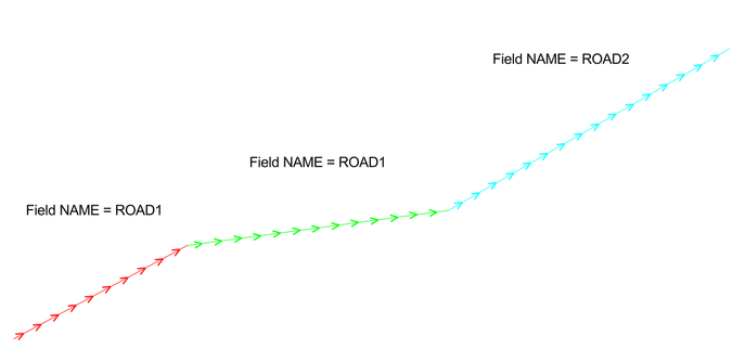

I'm trying to use MAPCLEAN and Dissolve Pseudo Nodes but I'd like Map takes into account a value of objet data field.
For example, I've 3 polylines with Object data (table ROAD, field NAME)
I'd like to join red and green because they have same value for field Name, but I don't want to merge with blue part, because it isn't same value for field NAME
Is there an option or a proccess to realize this juntion?

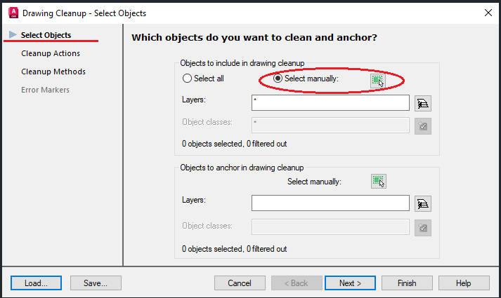

@O_Eckmann
Why do you need to dissolve that node?
Based on your description, you can do it by selecting the red and green lines individually. If you only select the red and green then you'll will exclude the blue line during the operation.
If that doesn't give you what you want, then you need to provide a more detailed explanation.

It's a solution, but I'm working on a large portion of country. I've about 5000 polylines and 300 road names.
So if I can found an automatic solution it's a bit more quick to do all my work.
I could transfer road name as layer, with MAPCLEAN I can select more that 1 layer, but all entities are considered as 1 selection, and dissolve doesn't take care of layers.
Native CAD command OVERKILL can take care of layers but it doesn't keep OD.

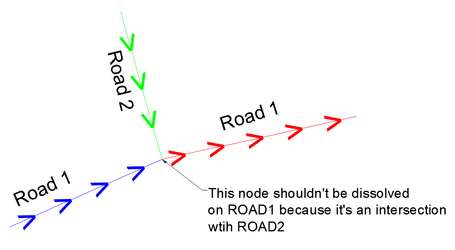

ODOUT & ODIN could be a good solution provide that new joined object keep it's Handle.
So I've tested on a little file : 8 polylines drawned from left to right, and 8 ther drawn in reverse side. I affect a linetype to view drawing direction.
I Copy these 16 polylines in different directions to see effect on algorithm. Then I use MAPCLEAN (to dissolve) and OVERKILL to join.
Behaviour is really amazing.
With MAPCLEAN, direction of new polyline are surprising, not depening on direction of each base polyline. I haven't found any logic.
With OVERKILL, some polyline are joined as polyline keeping Handle of 1st one. And sometimes command creates line with new handle.
And if you UNDO overkill command, each polyline receives a third point corresponding of 1st. You can't go back to you original file.
