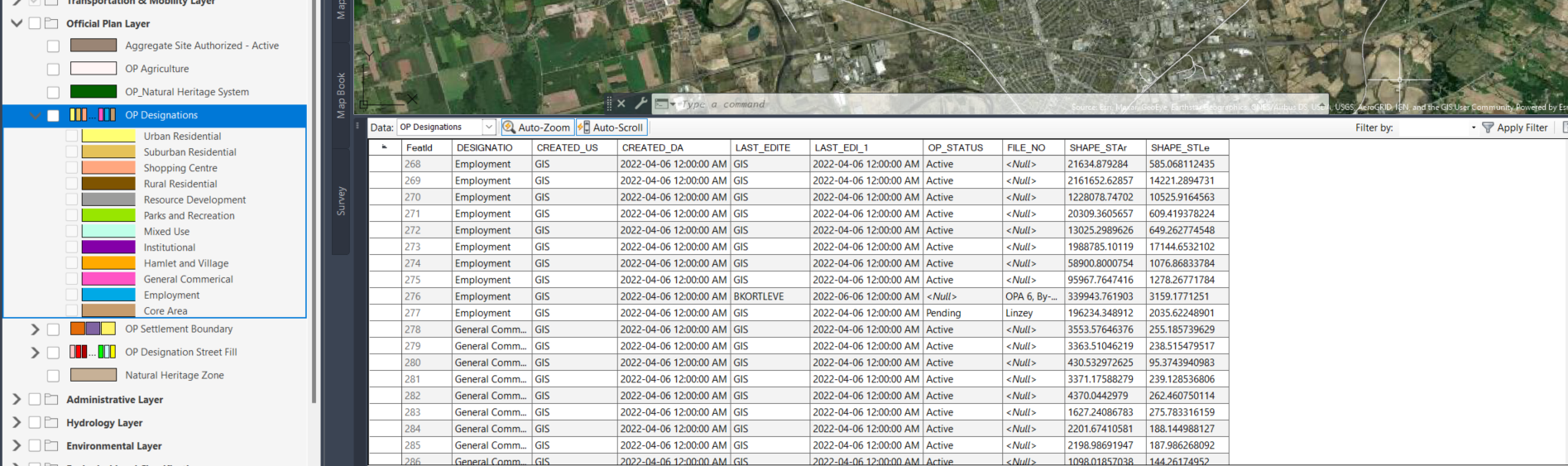

Thanks for getting back to me. Here is a screen shot of what I have so far. I am using shapefiles by the way. I did exactly what you described and changed the colors of each designation to the preferred color.
I think my main question is how can I save those colors and apply them to another dataset. Let say I am working in another municipality and want to use the same colors. Or how can I save a custom palette similar to how AutoCAD has default palettes and load them into my file?

O_Eckmann
Hi @JPaullXKUFL ,
Palettes are .PF files. You can find them in langage folder  of Map/Support.
For me in France, this folder is :
C:\Program Files\Autodesk\AutoCAD 2025\Map\Support\fr-FR
and if you edit a PF file with notepad, you can read something like that
;AECIPALETTEVER 1
;Autodesk Raster Design Palette
;Title: Palette DEM USGS
165,123,57
181,165,99
189,189,123
74,156,74
123,189,82
165,206,132
255,255,255
I think it's just RGB component to describe colors you want.
If you want to export association between color and value (of field), you could do that by saving a .Layer file, but this file contains data source. So if you want to apply same thematic to other source SHP file, you have to edit .layer file and search/replace original folder/file name source by new folder/file name, and then drag&drop this .Layer file into Map workspace.
