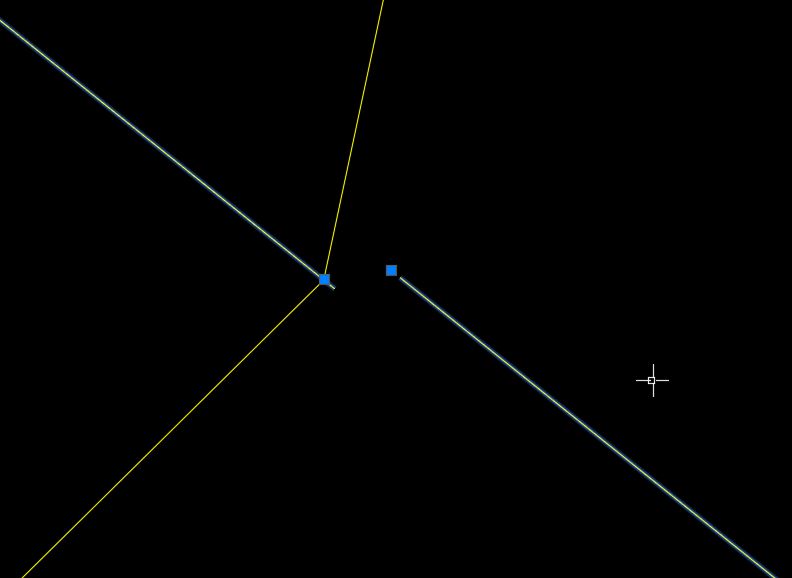

I am having an issues since I updated to Map 3D 2017.  I occasionally experience a problem where the lines will not intersect, but the display shows the vertexes as touching.   I have tried to redraw each line but the same issue continues.  I have attached two images for references.  Any help would be great!

not sure if I do understand correctly but we had an issue with 2017 that sounds similar - disabling Hardware acceleration did solve it,
Rob
Does your lines lie on the same plane, those views you posted looks like trying to connect far 3d objects with 2d like long time ago, try "flatten" command.
