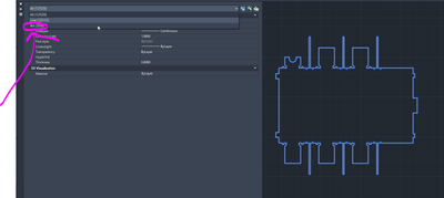

jmyersYFLYF
I'm running into the same issue on a different, but related example.  For the sake of clarity and simplicity, I have placed only one polyline object in this drawing.  The polyline in this drawing is also refused by the wipeout command.  My properties indicate it is only a polyline (no arc segments) as well as closed.  Performance issues aside, what is wrong with this polyline?
Message 5 of 10
jmyersYFLYF
Aaaaand, now I'm confused even further.  This also shows up in my properties as "polyline", but I specifically created it to include an arc segment.  Now I don't know how to tell if my 'polyline' objects are including arcs.

Message 7 of 10
cadffm
It would be new for me that you can see this information in properties palette.
For shorter polylines (not really good for such monster polylines you have)
you can use command LIST to check the arc informations,
but the explode-search4arcs workaround is the best way.
UNDO is your friend and the whole check takes seconds
and you can see visually where arc segments are.
Sebastian

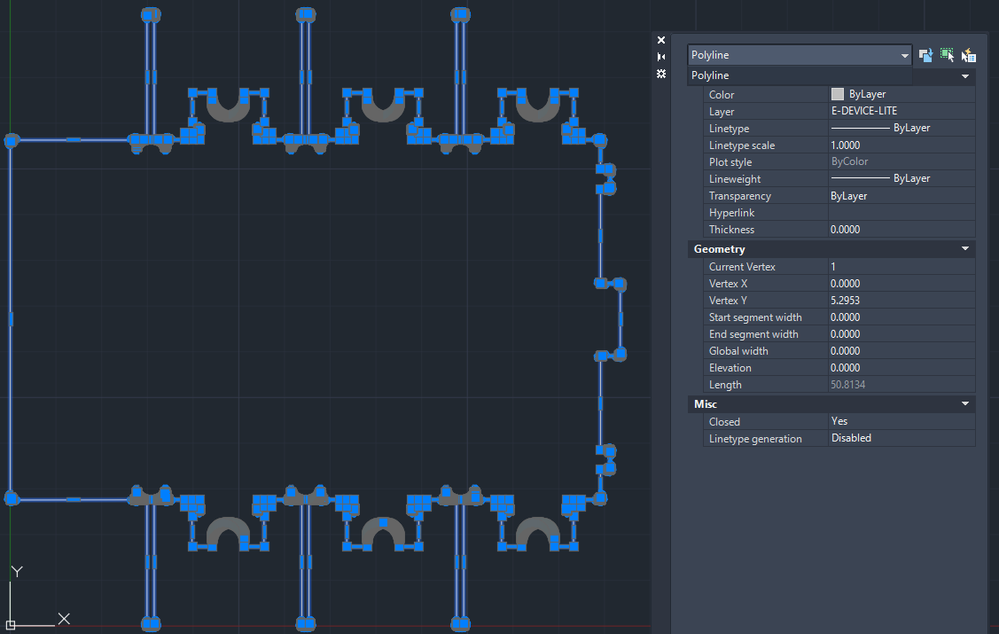

Message 10 of 10
jmyersYFLYF
To memorialize the process for others that run into the same issue (and who have the same lack of understand I had):
Here is the entire polyline joined and selected.  You can see the properties show it as nothing more than a single 'polyline' object:
With that object selected, I exploded the object.  With the resulting group of objects selected, the properties show it as a collection of lines and arcs (as shown below.)
From the properties window, I select just the arc segments and change their layer to another that is easy for me to pick out. I guess I could have also just changed their color to make them more visible, but I decided to change their layer.  Here is a zoomed in view of part of that collection of objects, so you can see where the hilighted arc segments stand out.  That allowed me to handle those portions, changing them to line segments.  In my case, I used the polygon tool to create the arcs out of segments, then erase the original arcs.
There, I hope that helps someone negotiate this confusing issue.  After I converted everything to segments, I joined them again, into a single polyline & made the enclosed polyline into a wipeout.
