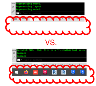

I am using AutoCAD LT 2025 with Windows 10 on 2 displays. Sometimes, the taskbar on display 1 disappears, but remains on display 2. I use Autocad on display 1. When I close AutoCAD, it returns. Does anyone else have this problem and know of a remedy for this?

No, I do not have it set to autohide. When it "disappears" it will leave a white box where the taskbar should be but no widgets/icon/date etc. When I press the Windows key it brings up the Start menu and the taskbar goes back to normal. But the second monitor will still have everything as normal either way. I'm using Win11Pro. My display 1 is a laptop and display 2 is a separate PC monitor. Doesn't matter if I'm hooked up to my work monitor or my home monitor, it will always disappear off my laptop. It's not the end of the world, just a bit annoying.

I also have the Issue. Task bar will go blank or it won't respond in monitor#1 while using AutoCAD.

LT2025 is not new: is this a sudden new problem or you? Or a new PC with a new LT2025 installation? Explain the circumstance?
Did you restart you PC yet? Try a different new log-in?
What does your I.T. person think the issue is and what have they tried to fix it so far?
Have you installed the 2025.1.2 Update yet? ABOUT command in your AutoCADLT will confirm what you have installed. If not, get it from your Autodesk Account Page here https://manage.autodesk.com/cep/#products-services/updates
Restart your PC afterwards please.
If that did not help... Set GFXDX12 variable to 0 (that's a zero): a restart of your AutoCADLT is required for it to take effect.
Also consider turning off LINESMOOTHING and LINEFADING variables: if still no relief then start GRAPHICSCONFIG command and change the 2D Display Settings pulldown from "advanced mode" to one of the other choices.
If all else fails, then turn off Hardware Acceleration as a last resort, does that help?

It is full screen on a desktop PC yes if i minimise it then resize to full it goes back to what it should be.

That's a workaround for now.
