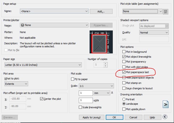

I read up on masking and wipeouts.  I decided to use a solid hatch set on a layer configured to print as a mask.
I've tried setting the color to 255,255,255.  I've tried setting screening to 0%.  It still ends up printing the underlying geometry.
This would be a solid hatch on a symbol placed in paperspace over a viewport.  The geometry to mask is in the viewport.  I use .ctb files for printing to an HP Color Inkjet that supports 17 x 11.

RGB 255,255,255 is "transparent".
CTB do not affect any RGB colorways either.
Plus there is no such color as WHITE when printing from AutoCAD if you are creating PDFs or printing on white paper.
So those things are not it.
Any reason you do NOT wish to use a WIPEOUT? Look that up in HELP, it's there for your need.
Also... content over a viewport has issues if you forgot to review your PLOT PAPERSPACE LAST setting on that pagesetup/plot command pop-up; I suspect this also needs to be considered after you fix the above colors issue.
In the absence of a CAD file or relevant screenshots from you, that's about all I can think of for you to start changing and testing. Give all of those a shot.

Is the ringed item in the image below ticked?

pendean - Thanks for the input.  Solid hatches vs wipeouts is one of those AutoCAD debates I try and steer clear of.  The short version is they both have their idiosyncracies and I'm more familiar with solid hatch as mask then wipeout.
hwalker - That's what I was missing.  We just switched from LT 2013 to LT 2023 due to no new activations allowed anymore.  Figure there will be a few settings things I overlook.  We don't do much heavy lifting with our 2D, but I'm glad to update (even if the bean counters aren't!).
I figure I'm going to have a few of these litle issues pop up.  Thanks for all the help!
