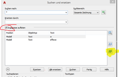

cadffm
Command: FIND

cadffm
Even if that was not a question in the thread, the user is very welcome to select certain blocks BEFORE or AFTER using FIND.
However, I understand the original question so that he needs no or just a simple window or cross selection
and then -> FIND to filter for Attributvalues -> Select all
done
Sebastian

cadffm
>>" but it hasn't let me select the blocks."
Either your program is too old and does not know the possibility yet,
or you need to get more familiar with the function.
Which program are you using? Command: ABOUT
I need to select them so I can add a shading to them.
Sebastian
