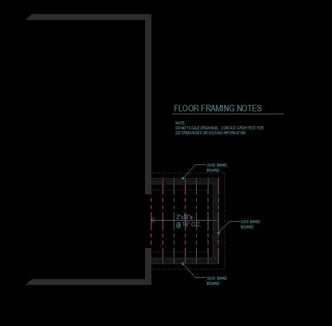

I have a simple bathroom floor framing plan for a residential addition and have xref'd a simple foundation plan to use as the base.  Eveything looks correct in modelspace and paperspace, but when I print I get random red leader points showing up.  To my knowledge these leader points do not exist in either of the drawings.  I have purged, audited (no errors), and set VISRETAIN to 0 with no success.
AutoCADLT 2022 screenshotAutoCADLT 2022 screenshotprinted documentprinted document
I am at the end of my rope with this!  Please help!

I would first do a quick select and select ALL leaders to see if there is a rogue one hanging about. Also is it possible to post the drawing so we can have a look at it?

I have used qselect to try and find any rogue leaders.  Nothing shows up.  I have attached the drawing file and xref file.  Any help would be greatly appreciated.
h_s_walker
I can't see any rogue leaders either. I converted it to 2013 format. I only have LT2016 and printed it using the PDF printer you have set it to use and nothing appeared.
See the attached PDF.
I would suggest you copy everything from modelspace into a new drawing and see if that sorts the problem. If it does you might have a rogue leader in paperspace
