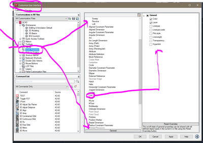

If all you want to see are more options in QPM (and what your missing screenshots of actual QPM at objects might show), those extras must be turned on and set by you for each and every object type in your files using CUI command's QUICK PROPERTIES section as shown below using LINE object type as an example

Thanks Pendean for your reply, unfortunately I can't reproduce the error in my autocad but the first time the quick properties didn't show more than 5 lines even though I set the custom properties correctly (I selected about 10 properties related to the Circle element) and there was no way to fix this.
Anyway, now I solved the problem following the solution for an old bug reported for ACAD 2019, so I selected an item and selected ALL properties, save and close AutoCAD. Restart again and the problem is fixed.
I know, it's strange, but... it works for me.
