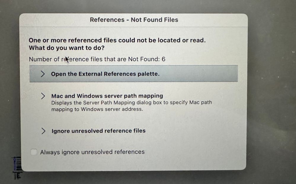

When I did this and opened the drawing, I got the message in the
attachment. Can you walk me through what to do next?

Message 15 of 19
schristianco
Message 16 of 19
paullimapa
Go ahead & click on Open the External References Palette
When I opened your dwg I did see there are a number of files attached but not found.
Usually if these files have been moved or renamed then AutoCAD would bring up this alert window to notify you as you open the dwg.
BTW, are you running AutoCAD LT on a Mac?

schristianco
Where is the External References Palette found?
Yes, I have AutoCAD LT for Mac.
