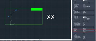

I would like to know if there is a wat to trigger a dim leader to go to the left or right? All of my dims are going to the right  when I home the text.

Edit the multileader style. See the image below

Is the dim style and mleader style connected somehow?

No, not at all. the less capable LEADER and QLEADER commands have more in common with your active DIMSTYLE setting, but there is no "automatic" dimtext with leader placement left or right, or up or down, in any of those commands.

I'd like to know if I could change anything on the properties panel in order to change the direction?

Try below

These are my options.

@h_s_walker has an MLEADER selected and showing you want you can do only with that object type, you have a dimension selected so the choices are much less and not the same.
Sadly, not with any dimension text.
