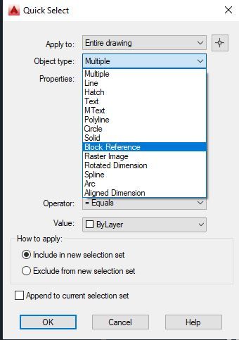

Hi!
Tried to use FIND to highlight a specific block in a drawing but it doesn't work. How to doit?

Right Click and then follow the images below. Just for information, the red items circled in the last image are a block called bolt

Thank you for good explanation!
