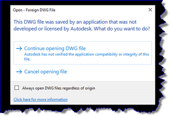

Alfred.NESWADBA
this drawing was not created with AutoCAD (or at least was sometimes edited with a non Autodesk product).
Next issue could be that you have set transparency values ... you know that AutoCAD 2004 does not support transparency?

Yes, it was created by a NON-Autodesk product, but that hasn't ever given me problems before. I didn't know about the transparency issue. I'll try altering that and see if it works.

same message for both previous attachments ( another application ) !!

>> Ignore the first attachment. This attachment is the correct one.
Same file again, no difference, same message about not trusted DWG-format.
BTW: I tried Autodesk LandDevelopment Desktop 2004 (which is based on AutoCAD 2004) ... the drawing opened well.
So it might be more an issue of the 2006 installation or the system itself (not enough resources).
