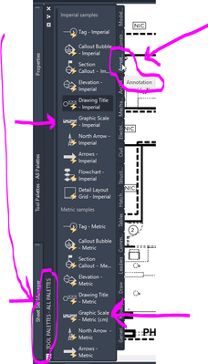

annotation tools palette?
Do you mean this?
Message 3 of 21
lscraig
Correct, but my selections do not show architectural units.  The selections are engineering units.  I know it is a simple setting, but I cannot find it in the menus.

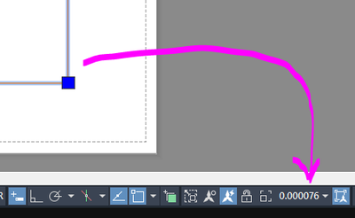

I simply opened your file in LT2019, ignored the alerts about missing XREFs, double-clicked inside the viewport and I see this in my list
Do you not have this set in OPTIONS in LT2019 on your side?

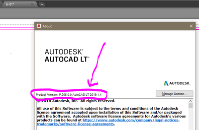

And does your ABOUT command in LT2019 show you as being fully updated like mine is

That's not the scale I am concerned with.  Scaling the model space is fine.  It is in the bottom tool bar same as you posted.  What I am talking about is a "graphic scale" that you place on the paperspace view to show the reader what scale the drawing is in a graphical manner.  So depending on what size the drawing is printed out, the reader can get a feel for the scale of the drawing.  See attached.

Thank you for the reply.  I have the following tools available which gives me a graphic scale available.
However, when I insert the graphic scale, there is only one scale setting available.  There are no architectural scales able to be selected.
I have looked for a way to change the setting for the graphic scale, but cannot find one except to edit the dynamic block.  Thinking it was my ineptitude with ACAD LT, I opened the A1 sample sheetset drawing installed with the latest update to see if different scales were available in that drawing since it was set-up by Autodesk.
Any user made blocks would be appreciated at this point.  I can draw my own obviously, but they won't be dynamic.
