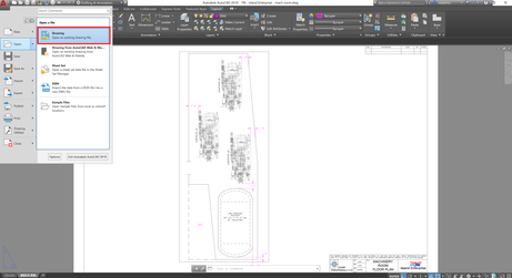

Posting a .dwg file. Others can open this file completely. This happens on every drawing I try to open.

So is your AutoCAD just not working with any file, other than this one?
Or is there an error message you need to tell us about?
The file you posted works fine too, see attached.

I have checked several ACAD file drawings. None open more than 30-40% - posted drawing is typical.

You have a software problem, not your files as we all understood your initial post.
What is your exact AutoCAD/LT version?
Windows OS?
What changed on your PC today or since you last used it?
When was the last time you restarted your computer?
Message 8 of 9
What is your exact AutoCAD/LT version? AutoCAD LT 2016
Windows OS? 10
What changed on your PC today or since you last used it? I bought a new computer and imported ACAD to it. Drawings open correctly on old computer. When opening, the screen says Autodesk DWG Trueview 2019. New computer, when I click on drawing, screen says Autodesk LT 2017 and doesn't open correctly. Note major difference I just noticed. Autocad program bought and installed on old computer is LT 2016. That is what shows in File Explorer. I used Export from old machine to new machine. In File Explorer, it says Autocad LT 2017 and the drawings are trying to open in Acad LT 2017.

Hello @Anonymous,
The issue is with the new computer because this issue can not be reproduced.
Can you launch the AutoCAD application by itself & create a new dwg file?
If you can launch it etc., its related to the location or system settings of the files.
