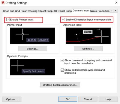

DYNMPDE negative value means that Drafting setting is kept, but value 0 turns off the Drafting setting.
Drafting setting is that you can open by entering DSETTINGS command.
To be easy, when you turn on DYNMODE set 1, 2 or 3, You can see the above image checked box.
If you set DYNMODE set 0, the checked box will be cleared.
However, If you set DYNMODE set any negative value, the checked box will not be cleared, but DYNMODE is turned off.
