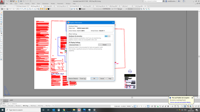

Hi Pendean,
Thanks for your response. My PC is approximately 3 years old, the operating system is Windows 10 (which I recently upgraded to at the time of upgrading to AutoCAD LT 2020), Ram is 16GB & 1333MHz, processor is Intel(R) Core(TM) i5-4690K CPU @ 3.50GHz.
I store my files on my hard drive.
When the drawing eventually opens, if I simply pan around then save changes it opens instantly next time of opening? If I don't save the changes, simply close it down & reopen it takes a long time to open again?!
I have pasted the screenshots requested above.
I look forward to hearing from you.
Mark

Thanks for the great info and great screenshots: you are missing a 2020.1.2 update, please install it first then restart your PC.
If that does not sort out your unusual problem, could you let us know where you save your files to and open them from?
