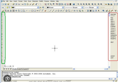

The green one is a toolbar,
how to get: See Postings & Links above
The red one is a Screenmenu, what is obsolet in L2025T
How to create/edit custom menu files (.cuix), your own toolbars and more, Command: CUI<enter>[F1]
