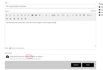

h_s_walker
No drawing was attached. Click the word ringed in the image below
