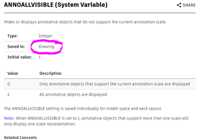

That's a per-dwg level variable setting @renrave
Are you by chance manually saving your DWG file soon after changing it to 1? That would set it for sure and make it stick for all of us. Find out. Test it for sure.
If you set that variable to your desired setting in SYSVARMONITOR command, it will alert you exactly when it changed and might help you catch the culprit.
