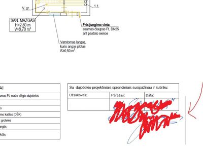

Hello. I insert a picture in my drawing using "insert object > paintbrush picture" and turn off its borders. (blue square is my selected picture)
When i preview a plot it doesn't show any border but when i print (pdf or printer) a black line appears. Why?

At the command line type IMAGEFRAME and change the value to 2
At the command line type OLEFRAME and change the value to 2

No fix, it could be in your image too: try referencing a clean image file with IMAGEATTACH command and see if the problem goes away.
v.juustas
Thank you, that helped!
