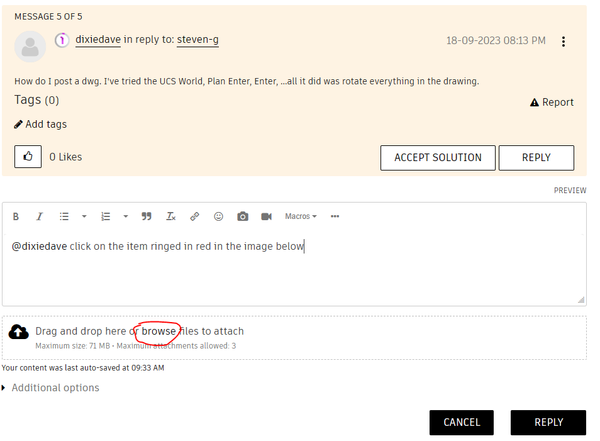

How do I post a dwg. I've tried the UCS World, Plan Enter, Enter, ...all it did was rotate everything in the drawing.
Message 6 of 9
h_s_walker
@dixiedave click on the item ringed in red in the image below
