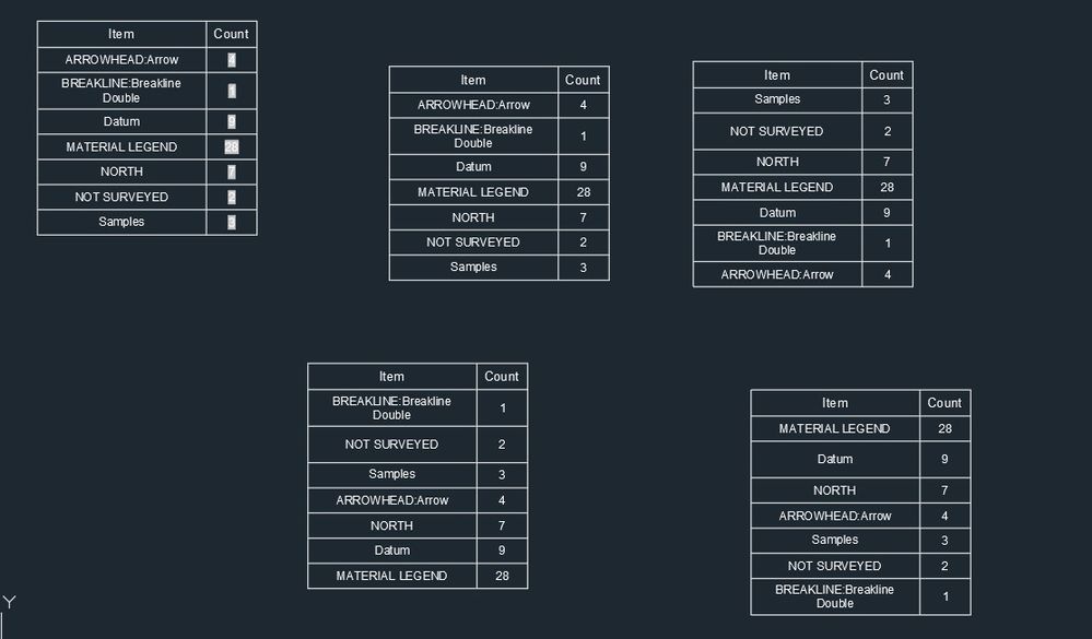

Good Afternoon,
We use count tables for our Legends but currently it sorts by alphabetical order - is there a way to manage the order of the rows in the table? I don't mind whether its a drag and drop I do each time or whether its set into the background of the table.
Many thanks

@d_salesU4WW6 I've just been working with ChatGPT and have the following lisp for it. It will ask for a column to sort by (0 is the first column). It will recognise if it's letters or numbers and will then ask if you want to sort A-Z or Z-A or 1-9 or 9-1. See the image at the end for the results.
The only problem that ChatGPT pointed out is LT cannot write fields in a lisp, so it converts all the fields to text.

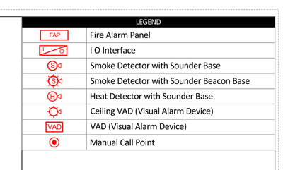

Unfortunately it needs to be a custom sort as we have CIE panels that would go above detection and interfaces would go near the bottom ect
I have attached below the way the table sorts now and how it would need to be sorted. At the moment its a manual task inserting and removing rows.

@d_salesU4WW6 Try this one. It asks Auto or Manual. If manual it will ask for the row order and then sort on that. EDIT: I just got ChatGPT to sort the table if it has blocks in it as well. The only problem is if the block has an attribute in it, it will lose the attribute value

  (if (null ent) (exit))
  (setq obj (vlax-ename->vla-object ent))
  (setq rows (vla-get-Rows obj))
  (setq cols (vla-get-Columns obj))
  ;; Extract data (skip header row)
  (setq data '()
        r 1)
  (while (< r rows)
    (setq rowData '()
          c 0)
    (while (< c cols)
      (setq rowData (append rowData (list (getCellData obj r c))))
      (setq c (1+ c))
    (setq data (append data (list rowData)))
    (setq r (1+ r))
  ;; Ask mode
  (initget "Auto Manual")
  (setq mode (getkword "\nChoose mode [Auto/Manual] <Auto>: "))
  (if (null mode) (setq mode "Auto"))
  ;; 🔹 MANUAL MODE
  (if (= mode "Manual")
    (progn
      (prompt (strcat "\nNumber of data rows: " (itoa (length data))))
      (setq input (getstring "\nEnter new row order (e.g. 3,1,2,4): "))
      (setq order (parseOrder input))
      (setq r 1)
      (foreach idx order
        (if (and (>= idx 1) (<= idx (length data)))
          (progn
            (setq rowData (nth (1- idx) data))
            (setq c 0)
            (foreach cell rowData
              (setCellData obj r c cell)
              (setq c (1+ c))
            (setq r (1+ r))
      (prompt "\nTable reordered manually.")
    ;; 🔹 AUTO MODE
    (progn
      ;; Column input
      (setq colIndex nil)
      (while (not (and colIndex (>= colIndex 0) (< colIndex cols)))
        (setq colIndex
          (getint
            (strcat "\nEnter column index (0-" (itoa (1- cols)) "): ")
        (if (null colIndex)
          (prompt "\nInvalid input. Please enter a number.")
      ;; Detect numeric
      (setq numeric (isNumber (nth 1 (nth colIndex (car data)))))
      ;; Sort order prompt
      (if numeric
        (progn
          (initget "1-9 9-1")
          (setq order (getkword "\nSort order [1-9/9-1] <1-9>: "))
          (if (null order) (setq order "1-9"))
        (progn
          (initget "A-Z Z-A")
          (setq order (getkword "\nSort order [A-Z/Z-A] <A-Z>: "))
          (if (null order) (setq order "A-Z"))
      ;; Sort
      (setq sorted
        (vl-sort data
          (function
            (lambda (a b)
              (if numeric
                (if (= order "1-9")
                  (< (atof (nth 1 (nth colIndex a)))
                     (atof (nth 1 (nth colIndex b))))
                  (> (atof (nth 1 (nth colIndex a)))
                (if (= order "A-Z")
                  (< (strcase (nth 1 (nth colIndex a)))
                     (strcase (nth 1 (nth colIndex b))))
                  (> (strcase (nth 1 (nth colIndex a)))
      ;; Write back
      (setq r 1)
      (foreach row sorted
        (setq c 0)
        (foreach cell row
          (setq c (1+ c))
        (setq r (1+ r))
      (prompt "\nTable sorted automatically.")
  (princ)
Howard Walker

d_salesU4WW6
You are amazing! Thank you so much! If I'm using a COUNT table will this still update when blocks added?
Message 14 of 16
h_s_walker
@d_salesU4WW6 Yes. If you look at the image I posted that was a count table I created, and I added the blocks to it. Just remember that the fields will not be remembered so you will have to keep a spare table somewhere just in case you delete / add blocks, and then you don't have to count them again, just copy the table and run the lisp on the copy.
Howard Walker
