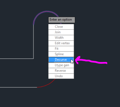

mauri.land
Thank you for the answer. I'm trying your solution, but when I digit EDITPL (I think this is the command I have to use in the italian version) I have to choose from the options below:
I think I have to select "Rettifica" that means rectify, but it converts the arc into only one segment:
Message 4 of 9
h_s_walker
Those commands are for a polyline (from what I can tell with google translate). Can you post your drawing so we can have a look at it and see if what I say is correct

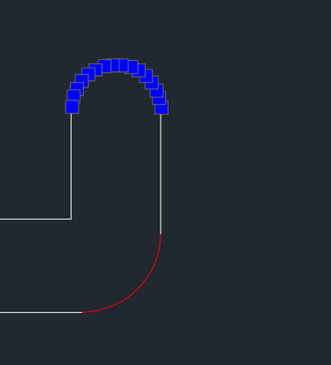

mauri.land
Sure, this is an example. Inside the file you can see:
Above, the result that I expect
Below, what I get instead.
Thank you

pendean
Community Legend
Community Legend
Thank you
In your sample DWG file, "DECURVE" option in PEDIT command does nothing to change it here
What are you actually trying to do? Reduce the number of straight lines to make it a smooth curve?
I can EXPLODE your original to get what you want in your sample file

mauri.land
I just have noticed that the arcs become polyline just after the PEDIT (alias EDITPL) command, without selecting any option, thank you!
Anyway I'm trying to do this because the command XCLIP (alias XRITAGLIA) requires a polyline and I was trying to use it to create a clipping outline for a texture that I have created using rectangular series.
Message 9 of 9
mauri.land
This solution works, even if it is not possible to decide the number of segments, so the final result it is not excellent
