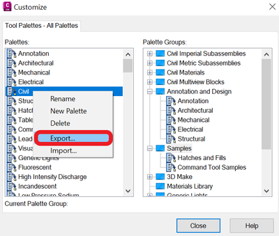

Read these links:
On Civil 3D, when you right click on the Palettes Groups side (right side) it allows you to save as *.xpg
On Civil 3D, when you right click on the Palettes side (left side) it allows you to save as *.xtp

I appreciate the information. I'll post in the Autocad Architecture Forum. I wish I had the export options you show in the photos existed in ACA24, but that right click menu doesn't exist. No idea why, other than some decision made at Autodesk to strip it.
I attached the photo below showing what I see.
Is there a file or folder that contains the custom added toolpalette and grouping information that can just be copied/pasted to bypass this lack of export functionality?
