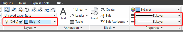

Thanks, JoAnn for your post. I tried to do what you suggested but those settings were already set as "By layer":
Also see how layer name "Bldg - C" is displayed with this blue outline. The rest of the layers don't do it.

db_2014
I just noticed if I go into layers pane it shows this and another layer as "Viewport overrides" apart from the rest of the layers:
What is that and how do I move them back into "regular" layers?

The picture at the top is what your layers normally look like. If you go more to the right you will see that there is a VP Color, VP Linetype and VP lineweight.
If I make the VP Overrides (Color, linetype and lineweight) different from the original then it will create a Viewport override folder as shown in the picture below.
You will need to set the color, linetype and lineweight back to exactly the same as the orinigal color, linetype or lineweight and the viewport override will be cleared. Refresh the layer properties afterwards

The light blue shading ALWAYS indicates that there are VP overrides.   Inside the Layer Manager, right-clicking is context sensitive and will permit removal of a specific VP Override, all VP Overrides per property, all VP Overrides in that Viewport, or all VP Overrides in all viewports, depending on what is selected and the right click option selected.
