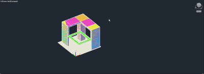

  • Click on below image to see how that your Model 3d object has many surfaces!! I don't know under what circumstances the drawings were made. You have a simple 3d CAD drawing - in general - and my advice is to always have a clean 3d models to avoid any unexpected problems.

2. "Click on below image to see how that your Model 3d object has many surfaces!! I don't know under what circumstances the drawings were made. You have a simple 3d CAD drawing - in general - and my advice is to always have a clean 3d models to avoid any unexpected problems."
Those surfaces are created from POLYLINEs using the CONVTOSURFACE command.  I use their "zero depth" geometry to indicate fabric coverings over my simplified structures.
These surfaces are intentionally offset from the bodies of the 3d solids 0.1" to avoid interference.
These surfaces do not cause problems in 99% of my work and VIEWBASE usually has NO problems rendering them.
I prefer to use the Wireframe & 3D Wireframe appearances so I prefer SURFACES which allow you to show Isolines and IMPRINT geometry as opposed to REGIONs.
Additionally I "stack" my 3D solids so my MODELSPACE in my drawings isn't messy (as your image shows by the end of it)  If you look closely at most of the 3d solids, there are imprinted lines in their faces that are convenient when VIEWBASing to show locations of features in the structure as it is built.  Honestly, if you tell me definitively (with proof) that stacking my 3D solids causes the problems I'm having, I will gladly stop stacking them.  But up to this point, it has never caused problems.
