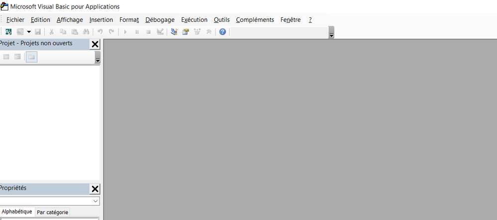

I'm trying to solve a problem from January  (last Windows update for my laptop) and I'm hopeless now...
I create the same topic on french autocad forum but it still not yet resolved. Maybe someone here get the same trouble and can help me.
Before Windows update, VBA on Autocad 2018 used to work perfectly on my laptop..
Now I have this warning:
https://knowledge.autodesk.com/fr/support/autocad/troubleshooting/caas/sfdcarticles/sfdcarticles/FRA...
I carried out all the steps described on this article. Unfortunately, in vain. I still have this problem and I don't know what is missing on my computer..VBA works in Excel, though.
I would me grateful if someone have some new directions.

Acutally I can't load any dvb file. I load them with the command GestVBA
I can even not access to VBA editor, every thing is greyed out as you can see.
I have Autocad 2018 1.1 on W10/1709 too.

Alfred.NESWADBA
your screenshot (info about VBA) differs from my one, that's what I get:
So you might have installed another product with VBA later than you installed the AutoCAD VBA Enabler or you installed an AutoCAD VBA Enabler which is from a different source. Uninstalling VBA-Enabler, then repair-install AutoCAD, then download VBA-Enabler from the Autodesk site and install it ... would be my next try.

m_latz
Solución aceptada
Hi Sofia,
try to uninstall your VBA 7.1 runtime and then reinstall the AutoCAD 2018 VBA runtime as you did a few times ago.
To uninstall the VBA 7.1 runtime you have to open a command prompt with Admin rights (you know how ?)
and execute the following commands:
msiexec /x {90120064-0070-0000-0000-4000000FF1CE}
msiexec /x {90F60409-7000-11D3-8CFE-0150048383C9}
msiexec /x {90F60804-7000-11D3-8CFE-0150048383C9}
msiexec /x {90F60404-7000-11D3-8CFE-0150048383C9}
msiexec /x {90F60407-7000-11D3-8CFE-0150048383C9}
msiexec /x {90F6040C-7000-11D3-8CFE-0150048383C9}
msiexec /x {90F60410-7000-11D3-8CFE-0150048383C9}
msiexec /x {90F60411-7000-11D3-8CFE-0150048383C9}
msiexec /x {90F60412-7000-11D3-8CFE-0150048383C9}
msiexec /x {90F60413-7000-11D3-8CFE-0150048383C9}
msiexec /x {90F60416-7000-11D3-8CFE-0150048383C9}
msiexec /x {90F6041D-7000-11D3-8CFE-0150048383C9}
msiexec /x {90F60C0A-7000-11D3-8CFE-0150048383C9}
msiexec /x {C33F3BA8-CA07-4449-012D-B043FE6029AA}
You can copy and paste the commands.
It is possible that a few commands run into an error, ignore that.
After close the cmd windows and reinstall the AutoCAD VBA runtime as you did before.
regards
Markus

No aplicable
Hello!
It’s OK now!! It works
Thank you all for your help !
