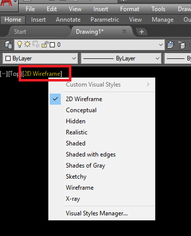

Hello.
I am trying to open the visual styles manager panel, but it will not.
Once I click there, the command applies and I can see it below in the command bar, but nothing happens though.
I have tried directly typing the command, looking for a solution in the forums, but nothing.
I don't remember changing any configuration lately and I have tried in other devices, and it seems to be working normally. Also, it doesn't look like the visual styles panel could be hidden somewhere, or at least I can't see it.
Regards.

imadHabash
would you try from below command line and type VISUALSTYLES , any changes ?  if not fixed please change your workspace and see if any good results ?  or try as below image

- I have tried to type the command --> nothing happens
- I have changed to a different workspace --> I can't make the palette to appear
- I tried in your way --> visual styles palette appears like enabled, but it doesn't matter if I enable it or not, it doesn't make anything. The funny thing is that the other palettes, like Materials editor, for instance, work perfectly fine.

Try to modify your screen resolution(display setings) 1280x720, step 2 came back at the recomanded resolutin
