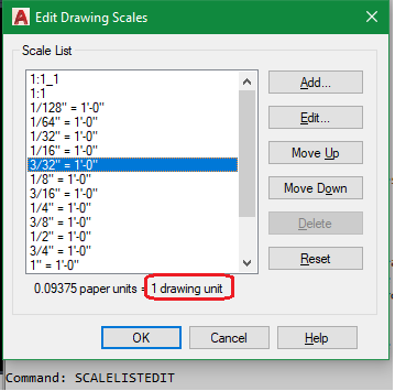

Then I executed the SCALELISTEDIT command and saw that for some reason all the paper units = drawing unit are showing 1 drawing unit which is incorrect.
The correct ratio should be paper units = 12 drawing unit.
To resolve this problem I select the Reset button and choose Imperial scales:
Now they all show the correct scales of 12 drawing units. You do still have a number of incorrect scales listed on the top of the list because these are still currently used by or assigned to objects like your paperspace vports.
