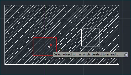

HI
you need to XPLODE the hatch first.
then only you can do trim.
if you do trim directly, it will trim the hatch based on inside objects.
EXAMPLE TRIM
ORIGINAL
AFTER TRIM
