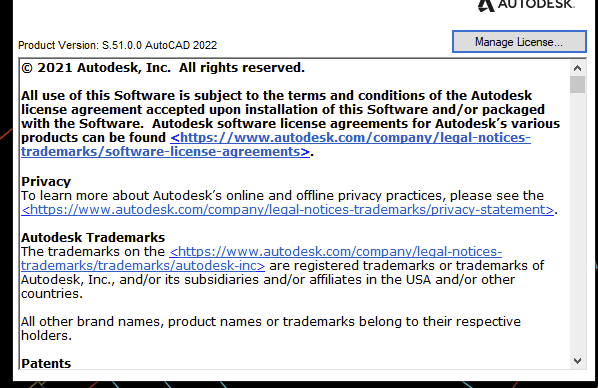

I'm trying to do a transparent zoom while in a command such as pline. I start the pline, then want to zoom to a new area, so I enter 'z then d (for a transparent dynamic zoom). This does not work. All I get is this:
I cannot get it to go into dynamic mode for zooming.

andersen9845BFT
Hi Alfred,
Thank you for your reply.
I am using the student version of the software (version S.51.0.0), not sure if that makes a difference for updating?
Message 4 of 12
Alfred.NESWADBA
No, it's the same software, so please install the update and transparent commands will work fine then...
- alfred -
Alfred NESWADBA
(not an Autodesk consultant)
Message 5 of 12
andersen9845BFT
awww yisss!  This did the trick. Thank you!  I didn't realize there was an update so soon. I just installed it last week.
Thanks again,
Andersen
Message 6 of 12
Alfred.NESWADBA
The installation media is the same as day one of AutoCAD 2022. Autodesk does not change the base installation files, so please always search for updates after installing a new product/release.
