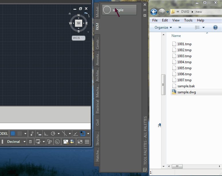

When I insert a block (.DWG file) from a palette button, I see the .DWL and .DWL2 files get created in the folder that contains the .DWG.
They remain until I drop/place the block, then they go away.
I highly suspect the folder that contains your blocks has WRITE and MODIFY rights, but not DELETE rights. Which is why the .DWL and .DWL2 files are being retained.
rkmcswain
Here is a screencap animation on my system.
Double check your permissions on these folders.
Is this a pure windows server? Or a SMB share off of a NAS box?

I just changed the permissions on my target folder, so that I do not have Write access, and the .DWL & .DWL2 files do not get created. Process Monitor tells me that AutoCAD still tried to create them, but that the access was denied.
