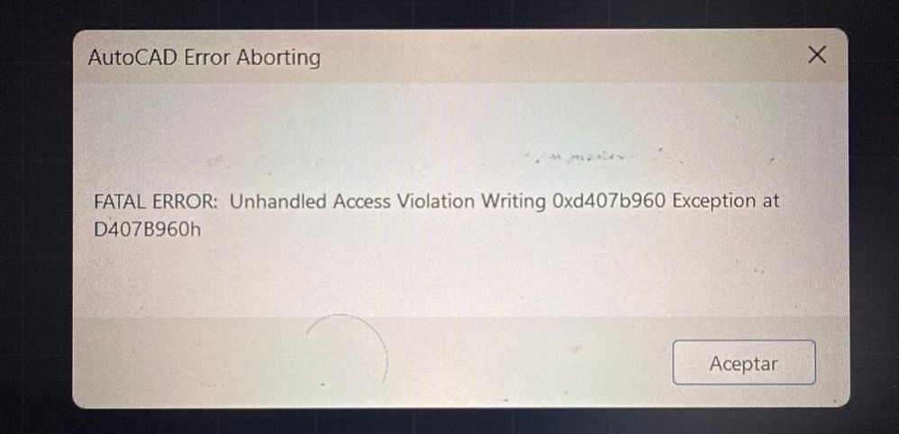

THIS FRUSTRATES ME AND I DON'T KNOW HOW TO SOLVE IT
ariel_eboli98
WhatsApp Image 2026-02-19 at 17.08.33.jpegWhatsApp Image 2026-02-19 at 17.08.06.jpeg

VincentSheehan
Are you saving the file when it drops out?

BhaskarMurari
Follow these steps:
  1. Set all layers to be on/thawed/unlocked.
  2. Use the WBLOCK command to export all data to a new DWG.
  3. Import existing layouts. See: How to import a layout from one drawing file to another in AutoCAD products.
  4. Purge and audit the file. See: Optimizing drawing files in AutoCAD with Purge, Audit & Recover.
  5. Save the file.
    refer this article: "INTERNAL ERROR:!dbobji.cpp@XXXX: eNotOpenForWrite" when saving a file in AutoCAD
