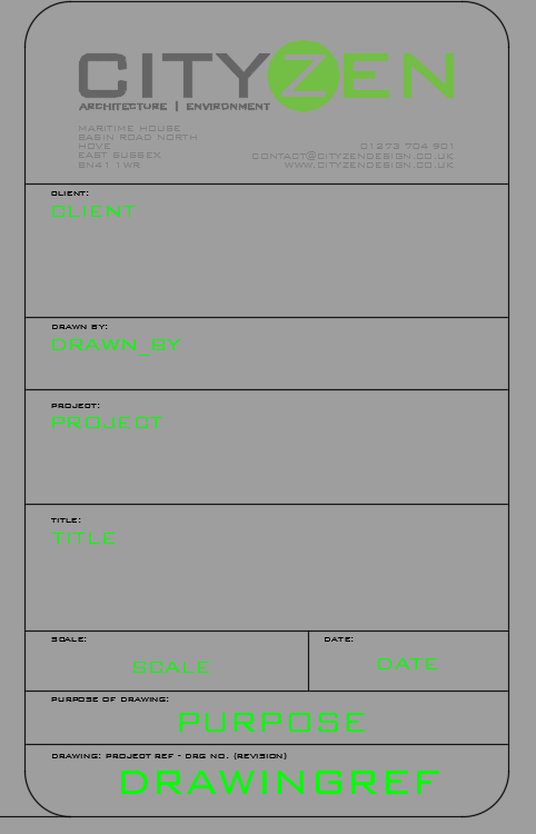

A lot of our drawings, within the title block we have text. (as part of an attributed block)
over the last month or so the text has started to move to the left randomly.
We are all on Autocad 2016 some with Full autocad some with LT, some mainly PC's and a couple of Macs
Anyone got any ideas?
first image is correct and spaced away from the title block, second image, (same block in a different drawing where the text has moved to the left)
thanks

Basic question: text is aligned to left, right or middle?

Hi again,
This one might make it a bit clearer.
The first image is the tile block, shown in block editor with the text (justified left) in the correct position.
The second image is the same block, within the drawing with the text shown that has moved to the leftCapture tileblock bad.PNG
I've added a stripped out version of the drawing if anyone wants to have a look also.
Thanks everyone

ATTSYNC or BATTMAN

ATTSYNC !!!!!!
Thank you so much
