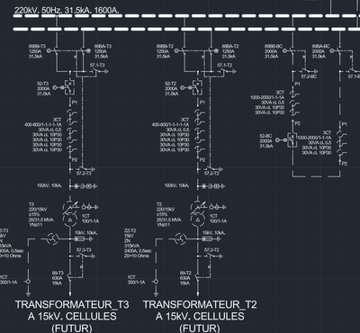

When I open any cad file on my computer txt appears massive. this happens only on my computer with any file. If I open the same file from any other computer the text appears to be normal.

I sent you the file I screened shot from.
But it happens to any file I try to open

Where is your issue exactly? Nothing wrong here in your file
Have you installed the 2025.1 Update yet? ABOUT command in your AutoCAD will confirm what you have installed. If not, get it from your Autodesk Account Page here https://manage.autodesk.com/cep/#products-services/updates
Restart your PC afterwards please.
If that did not help... Set GFXDX12 variable to 0 (that's a zero): a restart of your AutoCAD2025 is required for it to take effect.
If still no relief then start GRAPHICSCONFIG command and change the 2D Display Settings pulldown from "advanced mode" to one of the other choices.

nothing changed with LWDISPLAY
christian_feghaliJ94MM
I had no update to install.
setting the GFXDX12 variable to 0 worked.
Thank you

THANK YOU!!!!! I had the same text issue with any of my autocad file. Tried setting GFXDX12 to 0 and it helped!
