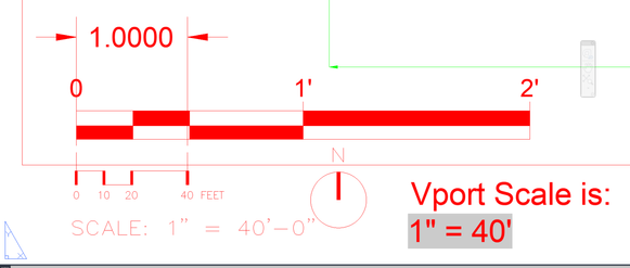

@jonaldgreen Update:
Why is your graphic block at this strange scale of 977.6053? Should it not be at 480?
OP: I checked the following:
1) Dwgunits command: drawing is in inches
2) In Model, Dist command to confirm that a 15' dimensioned reports back as 15'
3) Pspace layout "Siteplan - Quail Haven Ln" did a Zoom Extents and Erased the extraneous 1:10 vport
4) Created a new Pagesetup using built-in Dwg To Pdf.pc3, Arch D 36 x 24 papersize
5) Locked Vport in the current Layout
6) Created MText and inserted a Field to capture Vport Scale as 1" = 40'
7) ScalelistEdit command to confirm that added 1"=40' scale does contain the correct 480 drawing unit factor:
8) Inserted my own 1"=40' graphic scale in pspace that shows your graphic scale is off because at 1" the graphic scale should show a number of 40
See attached dwg.

Yep, the with the graphic scale settings of scale x, scale y & scale z = 480 and your vport set to standard scale of 1"=40' it should plot using the pagesetup I created to Arch D size pdf.
But you should edit your graphic scale because it's missing 1" = 40'-0" version.
There's only 1" = 30'-0" and 1" = 50'-0"

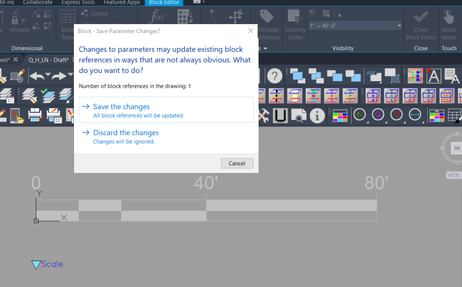

Since the graphics scale is a dynamic block just select it, right mouse click and on the context menu that appears select Block Editorpaullimapa_0-1784352732965.png
In the Block Editor on the ribbon's Visibility panel click on Visibility States
In the Visibility States list box that appears select 1" = 30'-0"
Click Set current button
Click New button
In the Visibility state name edit box enter: 1" = 40'-0"
Make sure the last radio button is selected click the OK button
Back in the Visibility States window with the newly added 1" = 40'-0" checked click Move Up button so that it's listed under 1" = 30'-0" then click the OK button
Select the two numbers 30' and 60' then click on Edit > Copy with Base Point or Ctrl+Shift+C
For base point enter: 0,0
Then hit the Delete key on the keyboard to Erase both of those numbers
Then on the Visibility panel select from the drop down list 1" = 30'-0"
Enter keyboard combination Ctrl+V to paste those two numbers back at 0,0
Then on the Visibility panel this time select from the drop down list 1" = 40'-0"
Enter keyboard combination Ctrl+V to paste those two numbers back at 0,0 again
Then double click each number and edit them accordingly to reflect 40' and 80'
Finally click the Close Block Editor button on the ribbon and at the alert window select Save the changes
Now back in the drawing window you can select the graphic block and there's now the newly added 1" = 40'-0" selection
