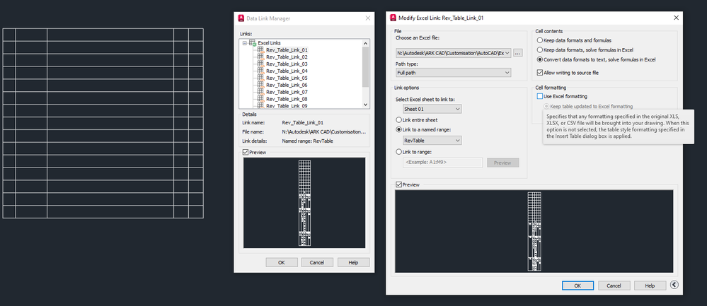

Isn't this jus typical.  Having spent the best part of two days trying to resolve to a sensible workflow, I found a solution to most of what I had identified I wanted to achieve.
But that solution retains a barrier to creating a template, as each table data link will need manually changing (or adding) to a new Excel data file (again, unless I have missed something).

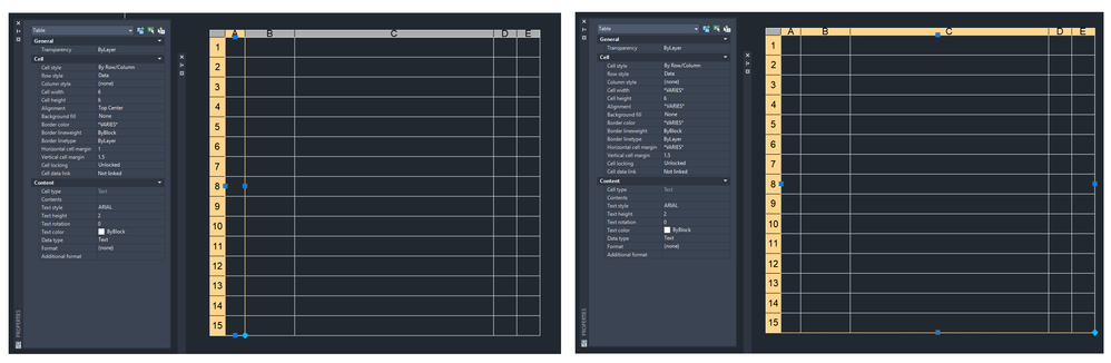

Anyway, here's how I got the table insert, format copy & paste to work:
  1. Insert table (no data link) & format cell size, text alignment, cell margins, text size, etc. - see image below.
  2. Copy & paste table.
  3. Assign data link as required.
With the data link, make sure the "Use Excel formatting" box is unticked under "Cell Formatting", or the table formatting performed in (1) above, will be overridden.
I think this workflow might be a halfway house to resolving the burden of Revision Control, but it will need to be tested in the real world before that is established.
It may be possible to further automate, but I think Vault is involved & that is not practical for small & fringe use.
Any suggestions on LISP to overcome this would be welcome.
P.S. I know LISP is needed to update the links, to I might be posting on that, next.

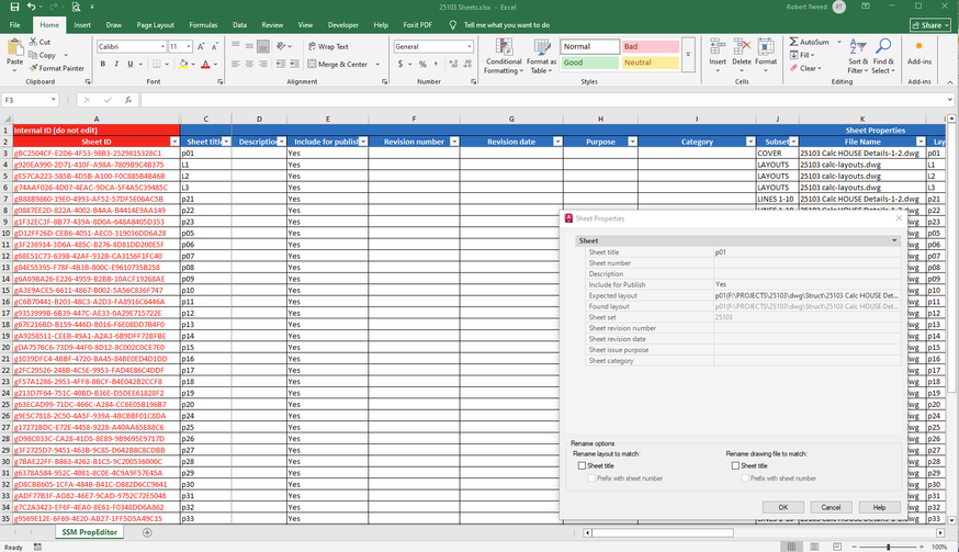

Have you considered using a ssm editor?  There are a couple in app store.
This would be one spot to handle all sheet related info. Title block, sht num, page num etc.  and revisions.
You could remove the multiple ranges, multiple links from your workflow.
Message 5 of 8

Hi @R_Tweed, I'm already using SSM & that App to handle the title block stuff
The Revision Table would take a bit of setting up & there would be a lot of fields.
The table is an easier, cleaner solution.  Well it would be, it there was a way to update the links & range without having to click inside each table & re-path.
