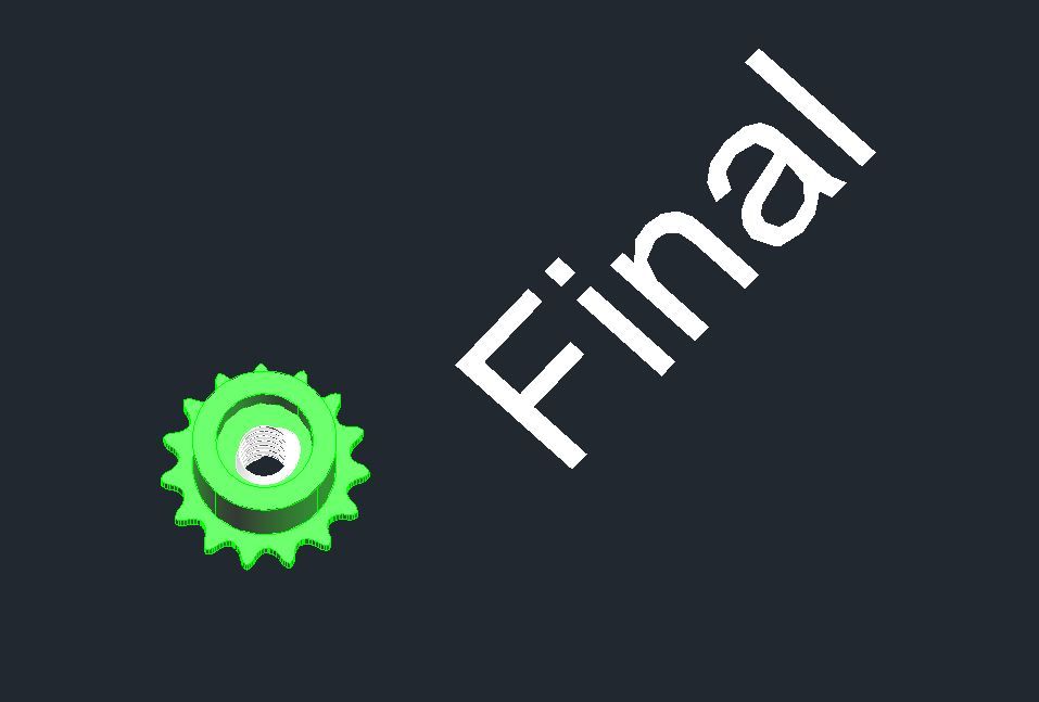

I imported a .dwg file into my current project as an XREF.  I then inserted it so it is no longer shown as an XREF but as part of the main drawing.
I am trying to subtract the imported 3D object from an object in the current project.  When I attempt to do this using the subtract tool, it does not work.  I am guessing it has something to do with the way I imported the object?
Does anyone have any ideas as to why I cannot subtract the imported object from the object in the main drawing?
If needed I can attach the DWG files here.
Thanks.

If you save it to version 2014 or older I'll take a look.

Sure thing.  See attached.
I also attached the newest version incase others might like that.
"Screw" is the dwg I imported (if needed), and "TC Gear" is the main project (the one in which I am trying to subtract).

The problem:
The screw is a block, you need to explode it, then you will see 2 parts. Use UNION command to combine the core of the screw and the threads.
Then you can subtract the screw from the gear.
calebUYG4X
Yes, that makes sense.  Thanks.
