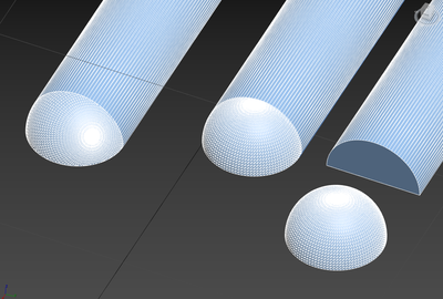

I have just installed 2022 and I am seeing really bizarre things. I need to do a solid in the shape of half a pill. The idea is to import this solid in 3dsmax and apply precise UVW mapping. So in AutoCAD, I drew two spheres and a cylinder. I then used boolean subtract to get rid of half of them and then boolean union to join them all up. When I have the two hemispheres and the half-cylinder lined up both spheres are showing the poles facing up as they should. After uniting the three solids, the poles shift randomly. When I bring the solid into 3dsmax, although perfect in shape, faces are all shifted. The following two images illustrate the process.

In 3dsmax I have perfect geometry but the faces on the unified solid make the UVW mapping quite impossible in terms of precisely moving the vertices. Why is AutoCAD shifting the sphere poles?
I tried other workarounds such as drawing a quarter of a circle, make t a region and then revolve it to create the hemisphere. All goes well with poles always facing the expected way but after using the UNION command it all goes a bit pear-shaped, I mean, in terms of shape, geometry is perfect but faces are not where they were supposed to be. Any ideas as to why is AutoCAD doing this?

Importing thee three into 3dsmax I et the following

I see the issue.
Work around I did, is use half a circle then revolve it to the shape and then join it to the cylinder.
The face maintains its position.
See attached file
Hope this helps.
Migsey_UK
Thank you very much for looking into this. yes, I managed to get it done that way yes. Strange how I didn't try that approach before. In any case, after the triangulation and when it comes to UV mapping, to have the poles rotated 90 deg feels a bit strange. Still better than before ;-).
