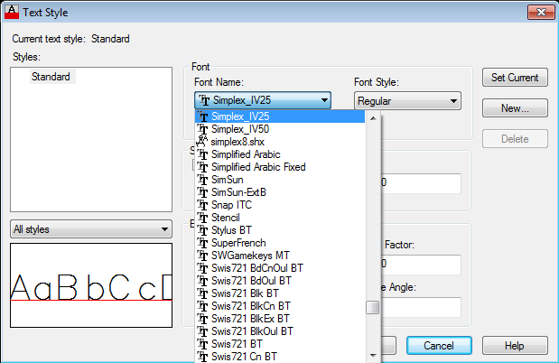

Really? As shown here BOTH simplex fonts .shx or .ttf can be used for text not  TTF font is only used for display purposes inside the MTEXT editor.

In older versions when use STYLE, you can select Simplex.ttf and use it as text or mtext but I opened 2013 it can't do that anymore.
I guess you can scream at Autodesk.
