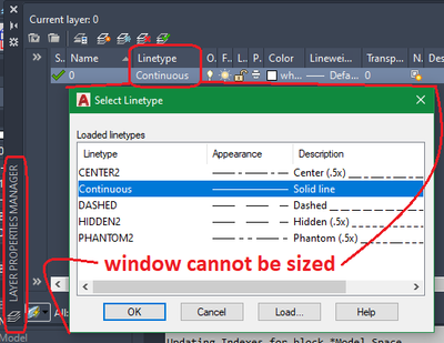

B. Layer Properties Manager:
1. Linetype brings up a small Select Linetype window that cannot be adjusted in size:
This should be made to match with the LINETYPE Manager window which is resizable:
