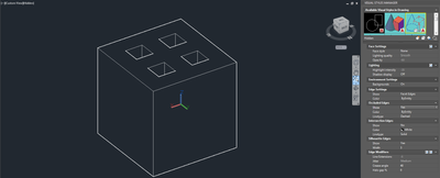

We have two CAD operators working on this issue and we've lurked through this forum as well as many others to find a solution but we can't find a stable, repeatable option.  In the photo's included below, a simple file which is also attached, has a block with 4 square holes running through it is shown.  We've turned the 'Show' parameter in the hidden visual style to 'Yes' but the hidden lines do not appear.  We've attempted several iterations of this solution, making our own visual style, changing to the 3D hidden style and a lot of different things happen:
  1. In one of our files several objects clearly show the hidden lines but some objects do not.  In one instance we copied an object from a drawing where the lines were not appearing and they did in the new drawing where it was pasted.
  2. The hidden lines are seen at different zooms, we adjusted the annotation scale which seemed to solve the problem on some objects but not all.
  3. The lines never appear.
At this point we think there's a display issue we're not seeing or a setting we need to change.  I've tried to use a simple example so that we can find a solution and extrapolate from there.
How did you create the screenshot with the hidden lines when you write "hidden lines do not appear"?
Because opening your drawing shows hidden lines (using AutoCAD 2017 Update 1.1 ... which version and service pack are you using?)
What you might try is to turn off the hardware acceleration (in the dialog of command _GRAPHICSCONFIG) and see if that changes the display.

Yes, we did the hardware acceleration and it did solve the initial issue, now we see the hidden lines of the concrete solid properly but our rebar disappears and we can only see the edges (since rebar is a cylinder with no edges).  Is there a better way to make the rebar so it will be properly visible?  I've included the file.
Change that two settings in your visual style, then run command _REGENALL

Thank you, problem solved for now!
