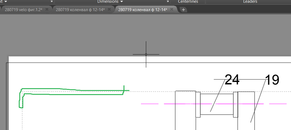

@Alfred.NESWADBA , hi!
That is the purpose of the dashed line of the layout?
(shown  in the picture, green-colored).
How do I change its dimensions?
Since it is invisible I could use it for my margins
Thank you in advance!
dashed line.png`
Message 5 of 11
Alfred.NESWADBA
In the device settings/paper format there exists a definition of border/none printable area.
If you define your own paperformat you can define this border.
- alfred -
